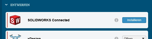

tested in firefox, edge and chrome. Reboot also tested.
Answers11
MJ
MJ2025-07-17
Do you use Sentinelone or Webroot antivirus softwares?
CW
CW2025-07-17
nope
CW
CW2025-07-17
also tested in privacy mode
MJ
MJ2025-07-17
So the install button just does nothing? I would perhaps try to uninstall the 3DX Launcher (if you have it installed) and try again
CW
CW2025-07-17
happend now. deinstalled .. removed the running processes and deleted the directory of the launcher
CW
CW2025-07-17
something changed. I have the role Innovate Buyer
CW
CW2025-07-17
but installfiles cant be accessed ... of course the applications wasnt installed
CW
CW2025-07-17
okay .. enough time wasted .. thats it. Impossible to install. Worst App and system i´ve ever seen.
CW
CW2025-07-17
Failure found: <2025_07_17-200943.75+0200d>{16416|22232}{ERR}:[Operations::DecryptArgument] Failed to access Web service behind "https://oi000396350-eu1-makers-compass.3dexperience.3ds.com:443/enovia/resources/AppsMngt/security/decrypt"! (Status code: 154)

It looks like something is blocking your browser from running the installation. Go to Platform Management > Members > Configure Member Options and Download the full installation pack. This is just a workaround for now. If you have a VAR I would contact them for support.
