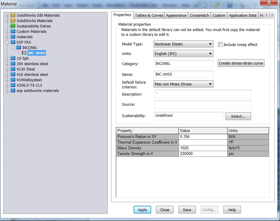

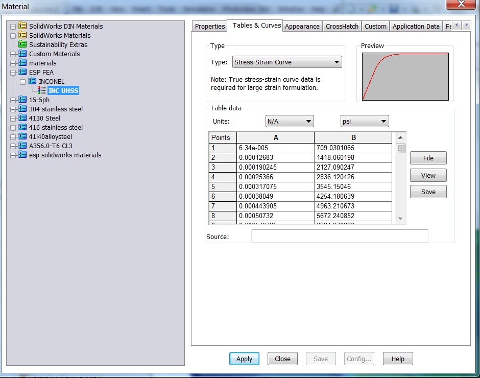

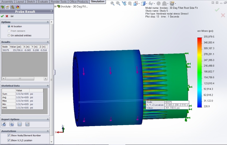

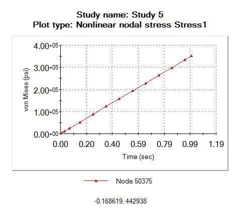

I'm trying to run a nonlinear simulation on a spline that's undergoing torsion. I want to see how it behaves past its yield point so I created a new material with the same properties as before and a stress strain curve seen in the attached images. Yet, each time I run the simulation the response seems to be linear as seen below in the response graph. As you can see, the stress rises well above the yield point of 212000 psi for the ultra high strength inconel. Does anyone have any idea on what I might be doing incorrectly?

you might want to consider a bi-linear NL plasticity model. In either case you need to be careful on what you are plotting: does node 50375 see a non-linear response with respect to "time". Obviously not by the looks of it. did you havethe large dispalcement flag set inthe NL properties? Youneed that set to invoke the equilibrium iterations.

Why would NL plasticity be used? Inconel is a steel and acts in an elastic manner until yield. I would expect a nonlinear response on that node because the stresses go past the yield point of 212000 psi. The stress vs. displacement plot also shows a linear response, which I didn't expect to be the case. Large displacement is set on.

Please upload your complete material data curve.  You can save it as a file in the dialog showing the strain and stress data.  There seems to be something fishy with the results.  What is your source for material properties?  Special Metals, which has the rights to Inconel branded alloys, is the best place for this information.
And one note on your material values (which won't change the results): you have a density value of 1020 lb/in^3 but it should be 1020 kg/m^3.  The way you have it makes the density about 28,000 times heavier than intended... making it perhaps the most dense substance known to man.

An element with 310ksi has a strain of .002356. According to the stress-strain curve I have it should be about .032.

you should check the elemental stress as opposed to the nodal average as the strain is for the element.

The stress strain curve was obtained by an outside lab. I couldn't find any stress-strain curve on special metal's website. The density value was an oversite, but doesn't affect the answer at all.

did you convert it to true stress and true strain? that is what the FEA package requires.

Yes, where in this model node 50375 is located.
Node is node , and element is element, strain is deformation of element. And you plot stress in node.
You apply torque . How? Linear ? Maybe try to plot node displacement in time instead node stress.
