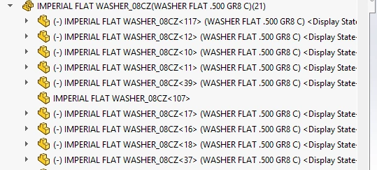

We have a random part that shows up in the feature tree but is not selectable. It's the exact same file as above and below. When the tree display is set to NOT display items together, this part gets a down arrow and can be expanded to show features, etc.
The part does not show up in the graphics area but randomly shows up on a BOM in the drawing.
Tried the purge command, and the part gets listed in the dialog box, but does not go away after the purge.

Can you save a copy of the assembly, delete everything else from the file except the grouped items an then upload it?

that is a good one.  Have you tried to see what happens when you suppress them all? Don't think I have seen it before.  I get some random qty errors but filtering the tree the part shows that it got selected in a mirror feature.
