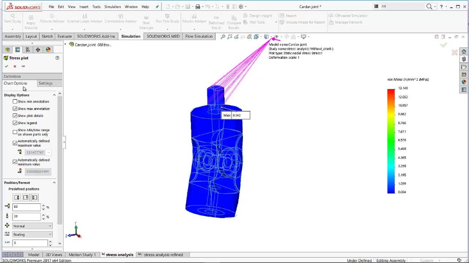

I am running a non-linear impact analysis. I am dropping a ball made of steel on a plastic part and i want to see the results (stresses, displacements) on the plastic part, but the analysis only calculate the results on the ball as you can see in the first picture. I set the analysis parameters as shown in the second picture. What i am doing wrong?
Thank you in advance,
Chris

Hi Christos,
Assuming that all BCs and results are correct, the following is a potential answer for you:
The stress propagation into the base part may be way lower that what you see for the ball. But it does not mean that you cannot see those stresses and plot them according to max and min in the base part. This process is shown in the attached video.
Hope it helps,
