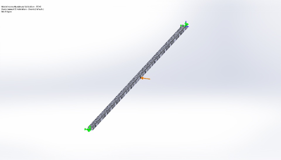

I am attempting to create a simulation study that would match real world results for an aluminum profile that we have designed (96" long, 6063-T5; fixed on both sides and has a 200 lb concentrated load in the middle). We have the real world displacement data for the described loading situation, and I want to get close to it in a reasonable and reproducible manner.
I have attempted modelling the profile as a beam, and running the simulation in the von-Mises plasticity material model, but that fails almost immediately, stating that the iterations are not converging.
I also modelled it as a solid, fixed both end faces and tried both a concentrated force (at a point) and a force at a face made by a split line, and received the same error (albeit with a  longer solve time).
I've attached screenshots to show how the profile looks, and the loading situation. I can't help feeling that I am missing something fundamental to how I am supposed to set this up. Please help!
PS. The only successful runs I've had were through the solid model, utilizing the "Plasticity - Tresca" material model, though I haven't the slightest idea why and it makes me question the validity of those results (along with the fact that the resultant displacement implies that it is significantly stiffer than it's real world counterpart, which is not expected due to the way the test was conducted).

I would recommend starting simple.
Does it solve with linear.
Does it solve with nonlinear solver but linear material.
Then you can start diving into nonlinear materials. If it works without the nonlinear material, I'd look at the definition of your nonlinear material.

to the best of my knowledge beams with NL material properties are not supported. you need a beam element with a sophisticated cross section definition which is not in SWX Sim.

I've looked at your file, and the first thing I notice is that the general stress in your linear simulations are well below yield with your setup. So Non-linear shouldn't give you the desired result since it follows the linear solution up to yield.
I'm not sure that I understand your test setup, but using fixed fixture on two surfaces is very hard to replica in the real world. Like supergluing the surfaces against a infinitly stiff wall. If I try your setup but with only the 2 bottom edges fixed (like a hinge), I get the result below. If I look at X displacement the result is 1,43 inches. But observe, that the part, due to its shape, is allowed to twist since the load is not thru the shear centre. This is probably not the case with the real product since the "ladder steps" would minimize that behaviour.

​, based on the above picture, I would suggest that you do not have the correct restraints on the ends.  (I presume you are trying to model the fat, drunk guy at the party leaning on the railing.)  A more forgiving restraint would give you more deflection obviously.
Also, have you tried your analysis with a standard C channel that has the same moment of inertia values as the shape you actually have?  That might give you more reproducible results.

Finding the shear center is not so easy. On my picture above it is on the left side of the part. On a simpler U-beam you could calculate it, but I don't know any way to find it in Solidworks. To locate a force on a point that isn't on the part you need to use a remote load/force. So if you want to add a load in the center of gravity, first you calculate it, to create a reference point. Then you add a coordinate system in that point and finally add a remot load/force.
I would use a simpler approach in this case and do split lines for each "ladder" step and restrain these surfaces from movement in the normal direction. Not perfect, but good enough i think.
