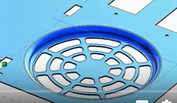

I am creating a sheet metal box.  I just realize I do not have Vent in Sheet Metal feature.  Doing the manual cut is time consuming.  What other option do I have?   Thank you

AW 2017-05-19 Best Answer
It is in SW2012....
2012 SOLIDWORKS Help - Vent
comment imagecomment image

Hi Anna,
I found it!  Thank you

I search Vent for command but can't drag it to the ribbon.
SC
SC 2017-05-22
Should be able to find it in the Sheet Metal features toolbar.
Steve C
CC
CC 2017-05-26
ok.  Thank you
