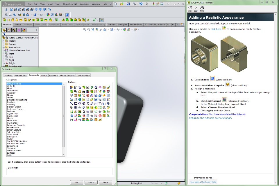

Hello, I'm a student who is recently trying to learn Solidworks. I currently have student version 2015 and a Zotac GeForce 1070 GTX(I'm saying this because I have had problems with rendering on some other software due to the new Pascal architecture). I started out with the tutorials and got stuck on the adding realistic appearance of the part 1 tutorial. I did search other discussion and got a different problem. Most other discussions had it where it was greyed out while mine is nowhere to be found, even the tutorial shortcut icon couldn't find it.

geforce is not supported by solidworks only Quadro, Fire Pro and intel P series GPU.

Unfortunately it would seem you don't have many options here ... Only "supported" graphics cards can use the feature.
