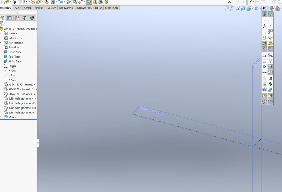

I have the HUD showing planes are visible. I also have all planes set to visible. For some reason, the front plane isn't showing up. If I highlight it it shows up until I click off of it. What could cause this?

The system planes extend to the SW file boundary, which is a 1 km cube centered on the Origin.
Plane frames are merely resizable representations. In this case, the Top and Right frames are resized and narrowed such that the Front plane is either rearward or forward of these plane frames.
Right click Front in the tree and select Zoom to selection.

This doesn't happen in all files, just a few of the assemblies. I can create a new assembly file, it shows up like it should. Same with new part files. Here are a couple more images. One shows all the primary planes visible in the FM, but only the Top and Right planes are visible in the Graphic Window. The other shows the same file with the Front plane highlighted in both areas. It's not too small or too large for the view. I know I can select it for constraints or dims by using the FM. Something is off, and I want to fix it. I guess I'm OCD.

It might help if you can upload a file where this is happening so that others can try to see what is happening. At first I thought that the plane "frame" had been moved off of the viewable screen, the same as some of the others have posted.
If I understand you correctly the plane is where you expect it to show, but it only shows visible when you click on it in the feature tree. Is that correct?

What's your graphics card?
Go to System Options>Performance and uncheck enhanced graphics. Restart SW and see if this returns.
