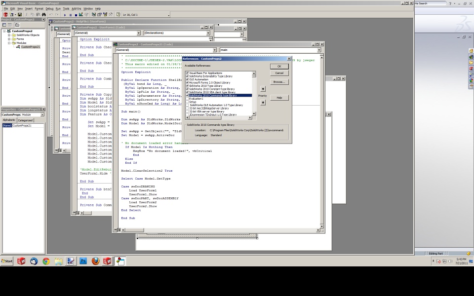

Awhile back, I created a few macros at my company.  They have been running well for awhile. They are shared on the network and used by a dozen or so engineers.  Recently, one of the engineers reported that his macros all started giving him the error message "No Document Loaded" for all solidworks drawings, parts, and assemblies.  The macros have continued to work for everyone else.  Everyone seems to be on Solidworks 2010 SP 4.0, but the engineer having a problem is on SP 5.0.  I checked his references and they appeared to be correct (see picture attached).  However, I also noticed that his computer has the same libraries for 2011 as well.  They are not referenced though.  I have no idea how he got 2011 type libraries on his computer.    Could that be causing the problem?  Or does anyone have some insight into what could be causing this?
