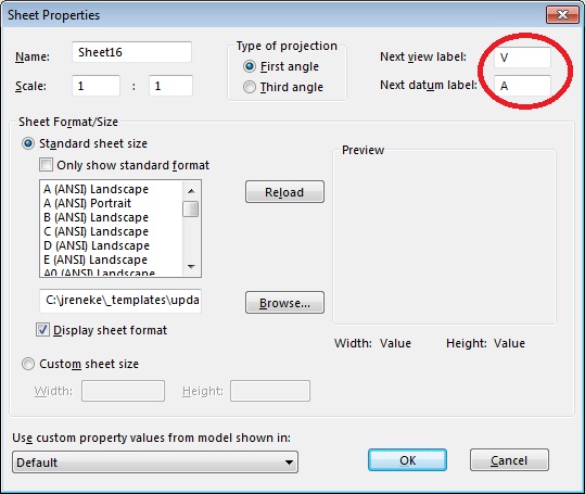

I'm writing a macro to create a drawing document with several detail views and section views. I'd like the macro to automatically assign the next view label to any created view, much like the normal user interface does. The information I need is available in the "Sheet Properties" (on sheet RMB -> Properties) window shown below. Does anyone know how to retrieve the "Next view label"?

I can not find a property in the view object that returns the label name, but IMHO it is possible to parse it from the view name.
A label is just a string, usually from A to Z, but also "qwe asd" is possible. Furthermore it is possible that "B" and "C" is used and "A" is not used in the drawing.
So I suggest to retrieve all label names and search for an unused name. See the code below
Andreas.
