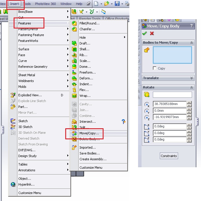

If you looking to visually rotate the part then click on the axis in the bottom left corner and then use arrow keys to rotate.
If you need the rotation permanent, then use Move/Copy body feature under Tools > Insert and seelct the rotate option.

There is no "Features" submenu in my "Insert" menu. And in any case, if it's going to lead to the same interface as when I click "Rotate Component" on the toolbar, then it won't help me, because the menu there doesn't allow me to rotate a part around itself by delta XYZ.
