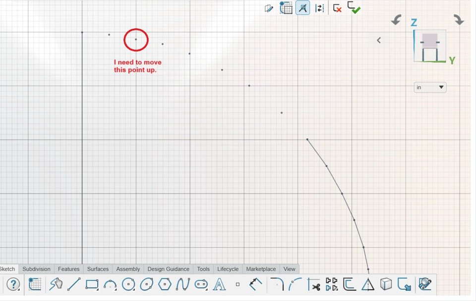

I'm new to SolidWorks.  I have previously created structures in a program called MEScope, which is a structural dynamic analysis tool.  I imported a section drawing of an object and have placed points on the line that represents the outer mold line (OML).  I then connected the points with lines.  Comparing the contour created by these lines with the OML, some of the points need to be moved to create a smoother contour.  In MEScope the points were defined by an X, Y, Z coordinate table that could be edited.  How do I move the points in SolidWorks?  FYI I tried importing the drawing and having SolidWorks convert it to a sketch and that didn't work out well.

can you share the file here?

Your screenshot is not a screenshot of Solidworks.  It looks like one of the Dassault cloud apps like xDesign.
There is no cloud version of Solidworks.  It is always installed locally.

"some of the points need to be moved to create a smoother contour" Connected lines is a segmented "curve". Would a spline prove more beneficial?

First and foremost, as Mr. Lewis mentioned, learning the difference between xDesign and SOLIDWORKS. Two entirely different CAD programs (despite both being owned by Dassault).

You can move the Point in xDesign: Left Click, hold and drag.
To position the Point exactly, you can add an X and Y Dimension to the Origin.

Post your screenshot from SW. You can move it by dragging using your mouse.
