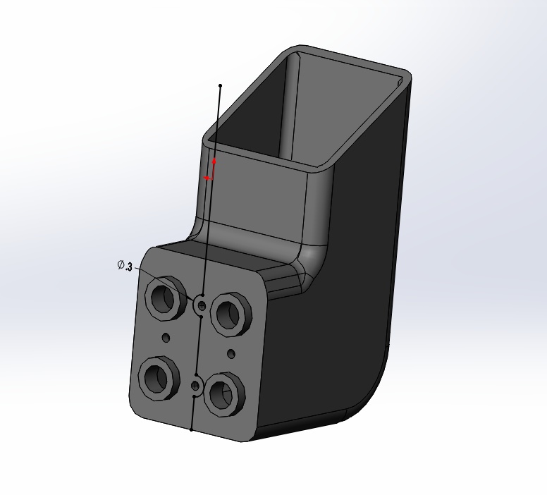

When I split with the non-straight line in the picture, it cuts the back that way, too. I've done this before to a box by sketching all the way around, but it didn't have any curves/fillets. I just can't get the process in my head here.

Here is a picture of my test box I did a few days ago. My goal here is to put plastic around those screw holes so I'm not screwing into the split line after I've printed it. The last photo is the original build.

Gotcha.  How about you split the part parallel to the back face first, about half way back, than you'll have a front half and back half.  Then you can use your current sketch to split the front half only, around the screws.  Lastly, combine bodies until you have the two left you need.

I think I understand what you're trying to do- I normally construct a surface to use as my trim tool for the Split feature. For shelled things like this it is easy because you don't usually care about the transition of the surface
I created one extruded surface with the behavior I wanted up front, a straight extruded surface for the back, then lofted the two surfaces together. Knit the surfaces and then use the resulting surface for your Split feature.

I think I did it right according to your instructions, although I'm not sure how to combine bodies yet. I used the Insert/Part to put them together with mates, but the combine failed for whatever reason. It looks like I could go ahead and print them now though.
Hopefully someday I'll be able to try Ryan's idea, but I don't know surfacing yet.
