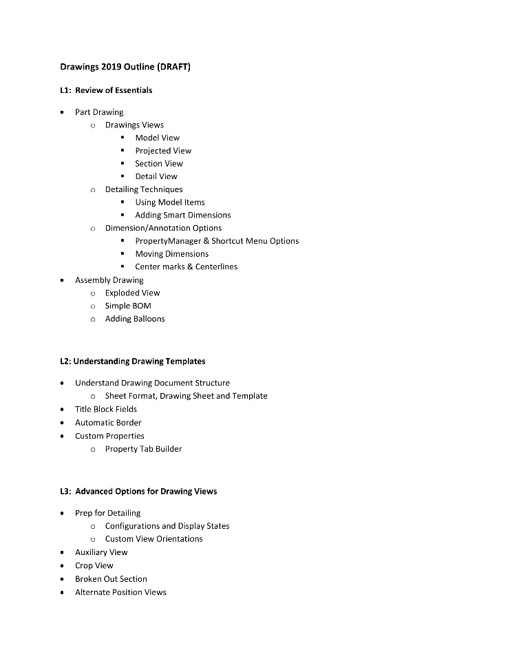

I have begun planning a brand new Drawings book for release with SW 2019.  This will be a complete re-write to update the information, examples, and format of the Drawings course.  I’d really like to hear from you about what you feel is the most valuable information to convey to your customers about working with drawings.
Is there anything in the current manual that you would like to see in the new material?
Is there anything new you believe has a place in the upcoming book?
I also have the unique opportunity with this course to possibly develop short, online training tutorial videos for My.SolidWorks to supplement the case study information.  So hopefully I can use this medium to help communicate information about drawings that may not present well in class or may not be necessary for all students to know.
Please let me know if you have any feedback or ideas about what should be part of this course re-design by adding comments to this thread.
You can check out the attachment for a rough outline of the current plan.
Thanks!
Rebekah

Have a quick case study showing the re-use of 3D Views. Even though most users do not have MBD, I would like to show how much time can be saved by using the 3D Views functionality.
The reality is that in a company they could have only one floating seat of MBD for creating 3D Views, but once they are created, anyone can use them in various ways. One is in drawings.

Hi Rebekah
great to see that drawings are re-designed!
we always had difficulties to deliver this topic well.
the handbook was some kind of "overloaded"...
some ideas from my side:
  •      the lessons should be sorted from easy to advanced
    that means the first lessons should be for new users and the last lessons should be suitable for advanced users
    That would make it much easier to use the handbook not only for essential courses but also for avanced training
  • you should add appedixes for special topics that wre not suitable for mainstream-users:
    • annotation views
    • MBD
    • advanced topic for BOM-equations
    • separate topic for intereesting document-settings (like "assign component color to drawing views")
    • print - best practice
  • the finished exercises should be printable on DIN A4. in that case the user can read through the requirements of the lesson and have physical copy of the drawing sheet on his desk (so there is no need to take a look on a different page).
IÄm pretty sure the new manual will help us.
thanks in advance for your investigations.

And good step towards MBD is using DimXpert dimensions on drawing. Not just video as appendix but it should be part of training.  Also a great time saver for drafter as it helps determining underdimensioned areas.
