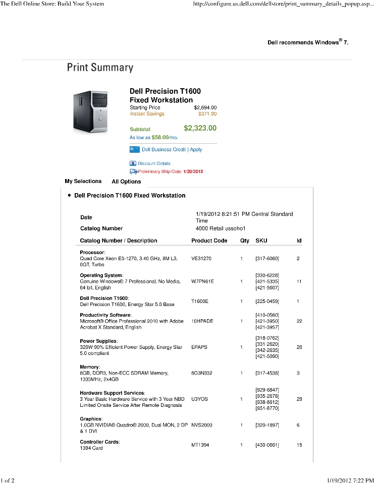

Here are the specs for what I'm ordering from Dell:
224-8671
1
Dell Precision T3500,CMT,Standard Power Supply,C2
317-8067
1
Six Core Intel Xeon Processor W3670, 3.20GHz,12M L3, 4.8GT/s,FPWS T3500
317-2670
1
12GB, DDR3 ECC SDRAM Memory, 1333MHz, 6X2GB Dell Precision T3500
331-1965
1
Dell USB Entry Keyboard,No Hot Keys,English,Precision Desktop
320-3316
1
Monitor Option-None
320-1843
1
1GB nVIDIA Quadro 2000,Dual Monitor,2DP and 1DVI,Dell Precision
342-1290
1
256GB Solid State Drive,2.5,Fixed Precision TX500
One thing I'm concerned about is that some solidworks users have experienced quirkyness from SSD.  I'm thinking I may want to change to a 15K RPM drive instead.  I also may change the CPU to a faster quad core instead of the 3.2 six core.
