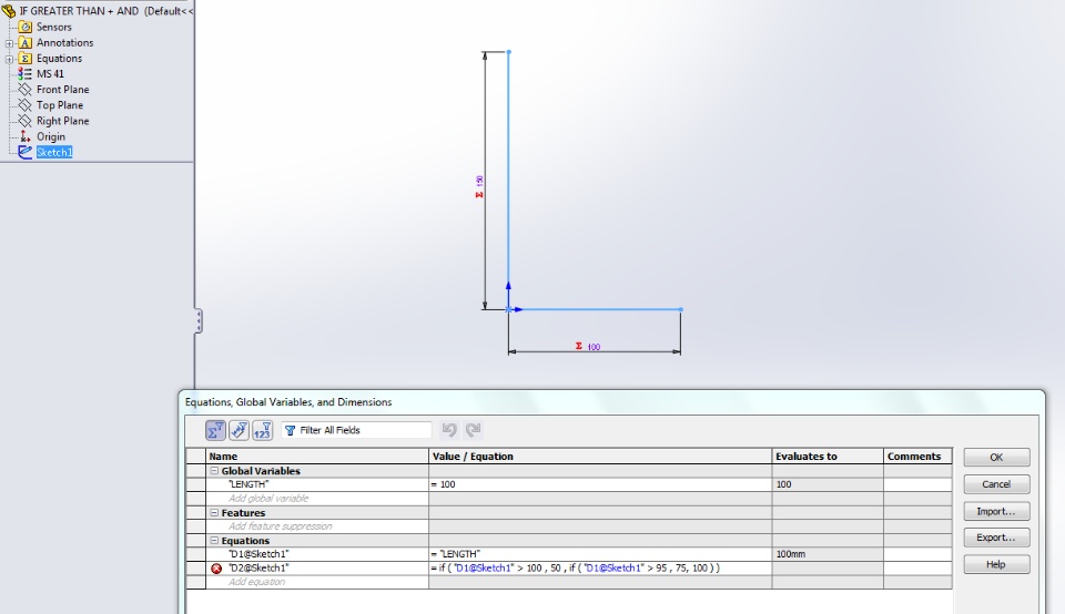

Dear All,
How to salve this nested equation error,
Looks like the new fancy "if" function is broken.
If you change either or both of the "if" to the old-fashioned VBA "iif" (just add a single "i") it will work.
Guess the old "iif" is the only bit of VBA that the new equation editor can stand.
Thanks,...
Thanks,...
