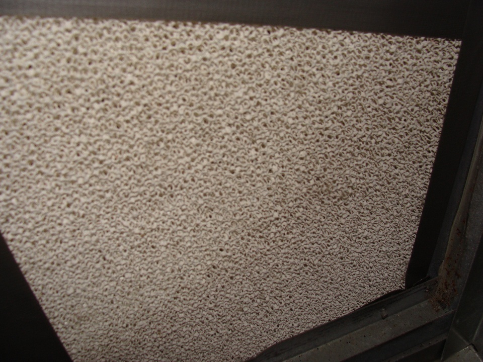

Does anyone know how to draw a nest-like air filter panel, or maybe know some place I can download a premade one? The specifications isnt that important, as I think I will have to make do with what I can get.
I´m thinking of a filter like the attached.

Well, it looks like a rectangular box with a texture map to me.  What's the application?

Crop the JPEG file, make sure only filter appearance left, using it as appearance file.
Edit appearance, in advance tab,insert appearance file.

The application is an air filter, and i want to simulate flow through the filter, so I will have to get the nest like structure, not only the appearance (which I think you're refering to?)

Kim,
Have you tried 3D Central?
or 3D CAD Browser?
or as Chaofeng suggested cropping your own image as a jpg file and using that as a textured pattern on the surface.

You might want to try Fill Patterns
