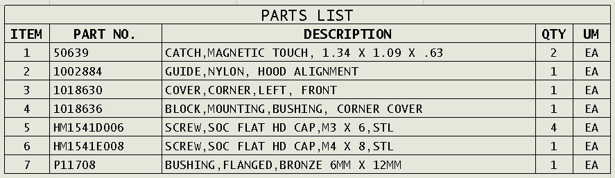

Need some help with BOM table formatting
disclaimer: I'm pretty weak in VB skills so please be explicit with your help.  I'm using the SolidWorks VB editor.
All,
I copied the add BOM example from the help file and tweaked it for my template location and that I want to use the my table anchor but what I cannot figure out is why when the table is placed on the page it comes in without the formatting that I think is saved with the template.  Do I need to explicity indicate how I want each column, column header, and row to be formatted or is there some option that tells the macro to use the saved formatting?
This is what I have:

Here is what I want the table to look like:

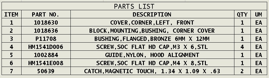

Here is what it looks like using the macro:
It seems like I might have to use some commands from the help page for ITableAnnotation but I'm not sure how to use them.
Any help is greatly appreciated.
