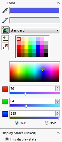

The component uses an appearance file 'satin finish aluminum.p2m' (attached)
The dominant color of this component is
Using the above equation the color value should be = 16733263
I use swModelDocExt.get_DisplayStateSpecMaterialPropertyValues() using swDisplayStateOpts_e.swThisDisplayState for DisplayStateSetting to get the AppearanceSetting.  But, the color value returned is 15592165
Why is it different? Can someone please explain.
How can I get the RGB value of the Dominant color from the appearance color integer value?
( I need RGB[79, 84, 255] from Appearance Color integer 15592165 )
