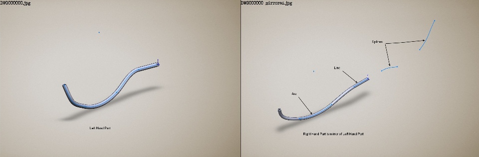

I am making a right and left hand part. The right is a mirror of the left. I have selected to have planes and sketches mirror with the part. As you can see from the image, the lines and arcs mirror, but not the splines which are in 3D sketches. I need those splines to dimension the drawings. Any ideas on how to get the splines to mirror?

I used Insert, Mirror Part. This is how I create a right and left hand part so changes in the master part will migrate to the mirrored part, unless the external reference is locked. And the 3D sketches did not mirror. The 2D sketches did mirror.

You used the mirror feature which does not mirror the sketches. Additionally, changes to the masterr part do not migrate to the opposite hand part. There is another mirror command called Mirror Part which creates linked opposite hand parts. This is the best way to create right and left hand parts. I think the 3D sketches not mirroring is a bug.
From the SW help:
Mirror Part creates a mirrored version of an existing part.  This is a good way to create a left-hand version and a right-hand version of a  part. Because the mirrored version is derived from the original version, the two parts always match.
