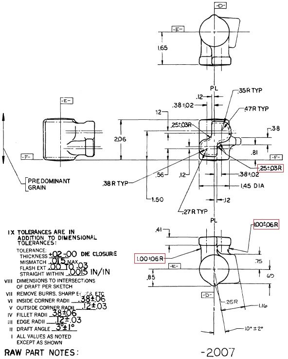

I was wondering if anyone can help me add the draft and fillets to the attached solid model so it matches the attached print.  I have tried many things and can not get any of them to look like the drawing.  Particularly the items highlighted in red boxes.   Any help would be greatly appreciated!!!
Using SW12.

Just took a quick look. It´s really hard look at the drawing, for me it would need to be bigger. Maybe I´m getting old. Started using SW 16 years ago at the age of 25, oh yeah that´s it.
One idea: You could model/sketch the radius you are having trouble with and maybe use loft with guide curves or something like that.

I can take a crack at it, but I am not very familiar with draft. I don't know how to interpret where certain dimensions are measured from. For example the 2.06 dimension, is that measured to the tangent edge between the edge fillet and the drafted surface? That's a weird place to measure from.

That is correct.  It is basically the dimension of the cylinder before you add the draft.  Always struggled with adding draft to parts.

I've never used the draft tool and so my approach would be to model it with the draft from the beginning. I'll see if I get anywhere.

You can't add fillets after you've modelled which are larger than the intersecting surfaces, otherwise the fillet would eat the whole surface.
For example, this works: (this is similar in sketcher as it is when applying a fillet on the model itself)
But if you tried to increase the fillet to anything greater than (or equal to) 1.0 you'll get an error. If you need a fillet with a larger rad, draw it in before, like this:
Then get rid of the 1.0 line. (I'm imagining this is just a part of a larger assembly; you would have other lines coming off of this part of the sketch.) When Solidworks puts in a fillet it makes both ends of the specified rad tangent to each face. If it can't then it fails. This is your problem with the 1.0 rads. As much as I'm staring at your model and the drawing, I really can't make out where those two .25 R lines are pointing to. I've got an idea, but your image is too small, sorry.
I don't have much experience with the draft feature -- I've used it once or twice in the tutorials and back in school. Sorry I can't help with that one.

Well, I got the part modeled ok with the drafts (I think), but then I ran into trouble trying to add the fillets. See the attached pdf for the steps I took to create the part. I am using SW2014 so you can't open my file, but I've attached it anyway in case someone else wants to build off of it. For the 1.00 radii, I had limited success using a face fillet. But as you can see in the images below it didn't extend all the way around. Also in the limited time I spent trying I wasn't able to get the .38 radii into all of the internal corners. Hopefully I've provided something useful for you to work off of.

I tried modelling your part from scratch, and I have an answer on the two .25 R fillets. They aren't fillets as you would use the fillet tool.
The .25 R dimension has two arrows, one goes to the internal rad on the "pipe caps" (as I'm calling them) and you have that modelled correctly.
The second .25 R dimension is on your "tab" feature. There is a small .0312 line there you can apply a .25 fillet on, which satisfies your front view. The only thing that does not work is in the bottom view there is a (general) .25 rad from the top of the "tab" (.75 dim) to the "pipe arms". That rad you will have to draw in on your Boss-Extrude2, Sketch2 -- applying a fillet there causes problems due to the compound curve generated between the "tab" and the "pipe arms".
(I'm assuming this is a valve casting of some sort.)
BTW, don't forget in your general notes about edge radii, outside and inside corner radii. You're missing those in the model you posted.
Edit: One other thing I noticed, you have your drafts applied in the wrong places. Drafts are usually applied to castings in order to ease their release from the mould. What is normally done is that part sides are tapered smaller as you move from the parting line deeper into the casting sand (or whatever material). So you're not trying to release a square from a square hole, you're releasing a trapezoid from a trapezoid hole, with the smallest face being inside the casting and the largest face on the parting plane (line). Don't try to make your model look like the drawing because that's what it looks like on the paper, follow the directions.

My apologies, it appears I am in way over my head on this. I can see where some of the dimensions are going, and I can see where you're having your frustrations. It appears that a number of the fillets are not true fillets - they're not tangent at one end, or they're a compound curve. I get what the drawing is asking for, but as for modelling it I'm stuck. If anyone can get this figured out, I'd love to see it.
