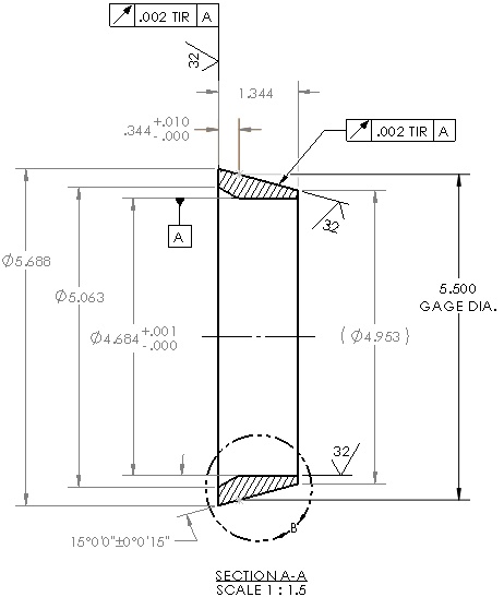

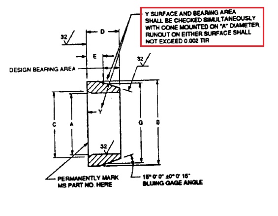

Can anyone verify that I am representing the geometric tolerance callout in the red box in the first picture correctly in the second picture?
Thanks,
Chris

I'm no GD&T expert, but it looks right to me. The only thing is you might want to use Total Runout rather than Circular Runout, because then it would also prevent the Y face from being concave or convex. It also might control the conical surface better too, although with the angle tolerance and surface finish already there I can't quite figure out how it would affect that one. But to be safe I think total runout is better.

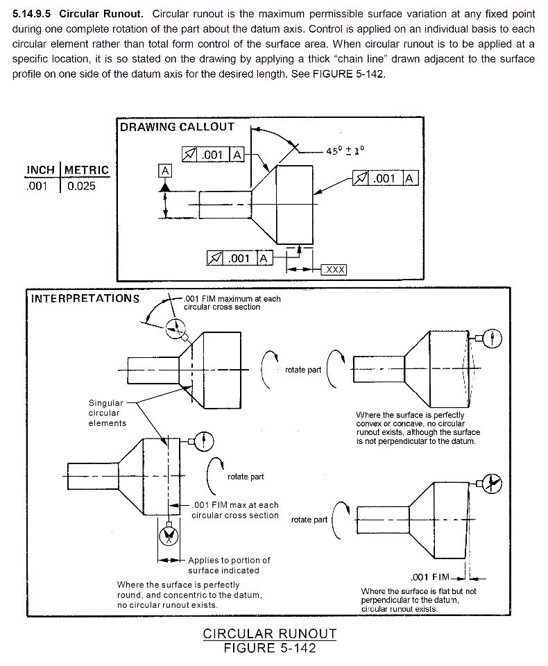

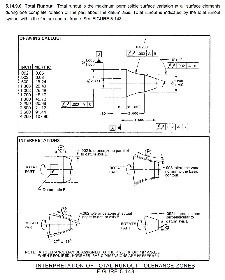

I do still think the same thing. The attached images are from the Drawing Requirements Manual (I couldn't extract the pages to individual pdfs for some reason). In the circular runout page notice the top right view in the bottom box where it explains about the concave/convex issue.
Agreed!!! Thanks again for your help Jamil!!!
