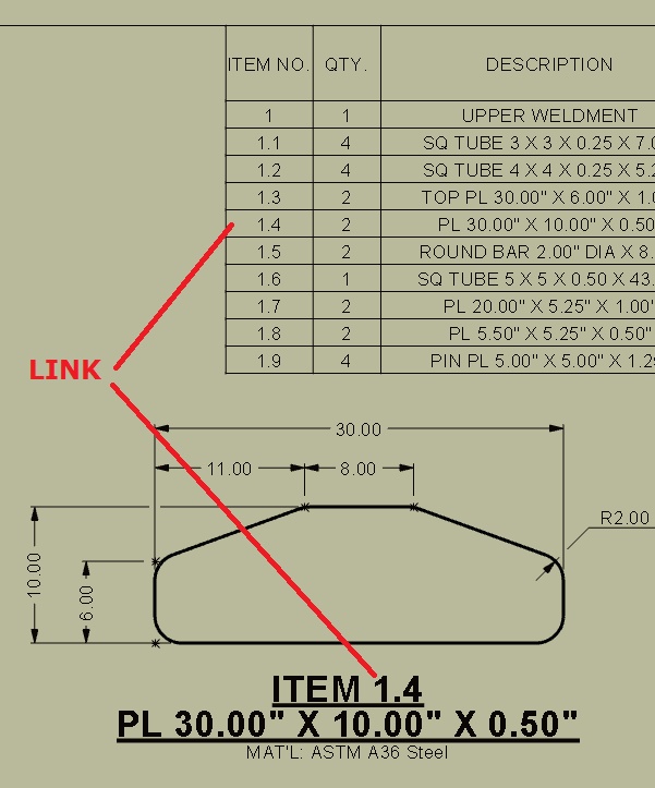

Hello I need help with a \\\$PRP Block Note that I am creating the Highlighted in red part is what is not working for me.
ITEM \\\$PRPwld:"CUT LIST ITEM"
\\\$PRPWLD:"Description"
MAT'L: \\\$PRPWLD:"Material"
I need the highlighted area linked to the BOM ITEM NUMBER (ITEM NO.) I know that I can link the 1.4 with a balloon on the page but I want it to happen automatically when linked to a view.
Any help would be appreciated!

I'm not aware of any way to link a Note to a BOM quantity, although it may be possible.  You can insert a balloon, remove the leader and the border, and adjust the font so it looks like a note.  You could have a seperate note for the other information, and align and group it with the balloon.  Would that work for you?

It wouldn't work the way I want it. I want the user to not have to select a balloon. I am wanting the item number to populate via the BOM on the drawing. Also I do not want the extra step of inserting an extra balloon.

One issue with
ITEM $PRPwld:"CUT LIST ITEM"
is the lower case in $PRPwld:
SW is very particular and must see all UPPER CASE letters as in your 2nd and 3rd lines.
That said, Item Number is not a Weld Cut List Property - it is a Weld Cut List TABLE property. I am not aware of a way to directly access it.
If you click on a balloon to add the item number to your note, then RMC on your note and select "Edit Text in Window" you will see that SW places a reference in the note to . Unfortunately, the object is the balloon itself (not the data in the balloon) and the object number is randomly assigned by SW. So this is not a repeatable nor stable reference for a parametric note.
One alternative - although still not parametric and easily the source of error - would be to create a cut list property to mimic the item number. You would have to manually type in the Item Number Copy. The last tab in the part Cut-List Properties dialog shows a preview of the Cut List Table. This is where you could cross check and ensure your manual input matches the SW assigned value. Then you could create your fully parametric note in your drawing that could link to:
ITEM $PRPWLD:"ITEM NUMBER COPY"
The downsides are the redundant data entry and the fact that this breaks as soon as someone re-orders the rows in the cut list table. If your lists are typically short and your workflow for drawings does not allow list reordering then perhaps this is workable.
Not a great solution...
