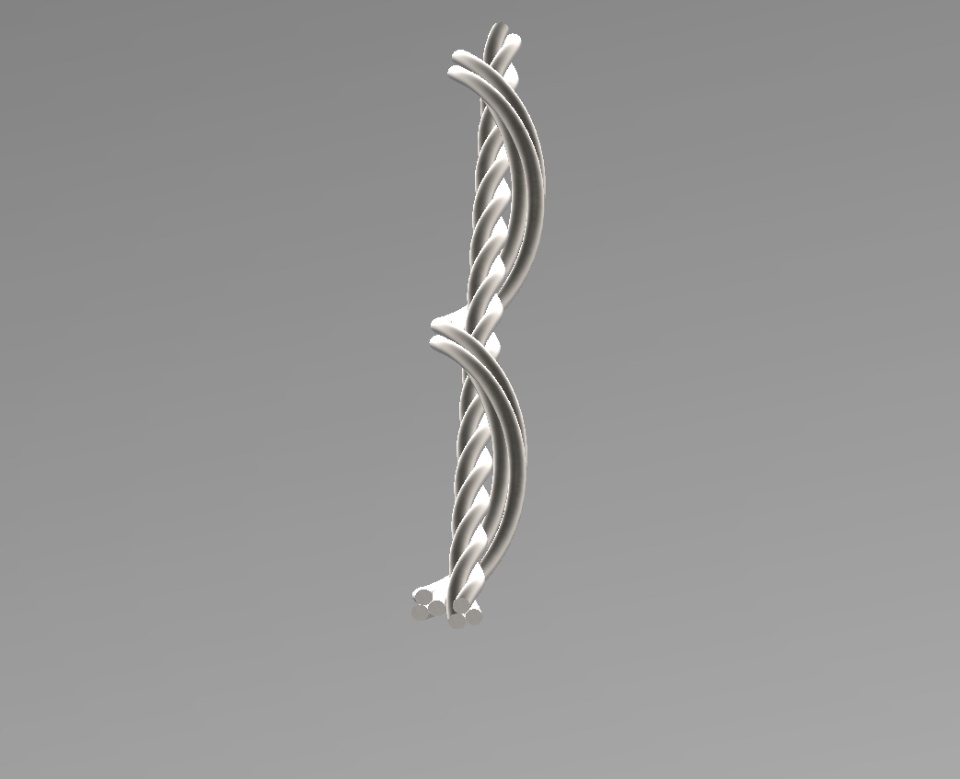

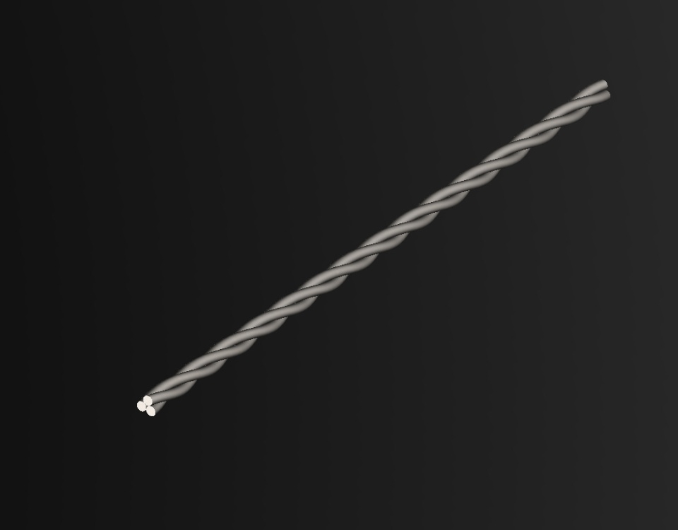

I've had a very frustrating problem the last few days that I can't get figured out.  I need to model a 3 x 7 strand.  The 3 means there are 3 wires twisted together into a strand - like this:
And then 7 of these "3 wire" strands are then wound together, with 6 fitting snuggly around the edge of the middle 1 (like a hexagon with something in the middle)
So, I'm starting with the above image, then going into something like this:
Sweeping along a helical path, which I would then pattern 6 times around the central one.
BUT, if you can see the problem...  the outer strand won't "twist" like the central one!  When I try to "twist along path" for the sweep, it says "sweep operation failed to complete.  Smooth path is needed for sweep with twist"
Please help!  I can't figure out what this means or what the problem is.  Is there another way to accomplish this without "sweeping with a twist"?  Any help is much appreciated.

CC 2012-03-20 Best Answer
Try "Helix Along a path"
http://solidmentor.com/modules/wiwimod/index.php?page=AdvancedHelixShapes
where your first path is the larger helix.

Following the steps on the link you provided, I'm running into the same problem, unfortunately:
"4. now use the surface sweep tool to sweep this into your "spiral" shape."
To me, this means I'm using Sketch9 as the profile and Helix/Spiral1 as the path...  which throws the error "Sweep operation failed to complete, smooth path needed for sweep with twist."
SolidWorks really doesn't like my helical path for some reason!

Is this what you're looking for?  I didn't download and look at your part so it's a bit of a guess.
Unsuppress the Body-Move/Copy feature, and see the whole thing.  You can play with the dimensions and number of twists to see how tight you can get things.

Hey everyone -
So, I figured it out...  It works the way I had originally intended if I just increase the size of everything by a factor of 100.  Literally changing nothing else.
Thanks for the help, though!

Matt,
Are your cables really small? Sometimes SolidWorks does have problems when you get geometry down in the micrometer scale.
You may be able to make your parts 100 times larger, then scale them back to the correct size.
If that doesn't work, you might be able to export the 100X models and then import them and scale them back.

This is exactly what ended up happening... I just scaled everything by 100x and it worked perfectly!
thanks everyone for your suggestions!
