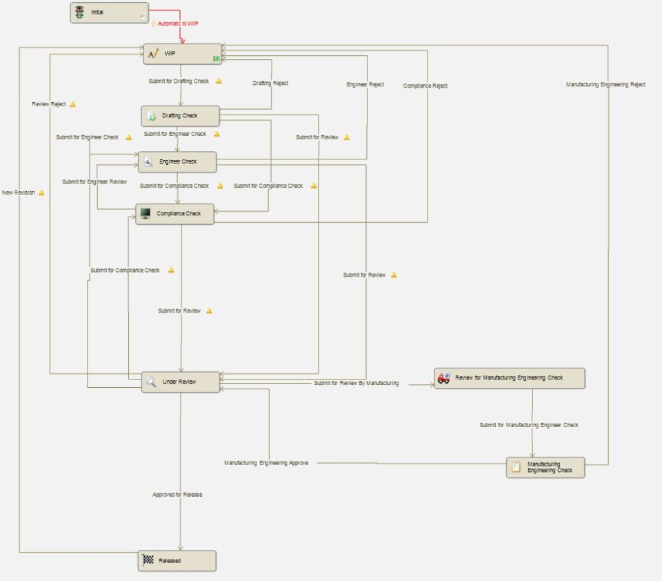

I am running documents through our workflow now for testing.  I can't get the Rev01 value to record anything on the data card (writing to the file is another issue I will tackle later).  Here is the workflow....

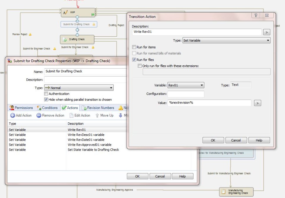

I have Rev01 currently to be set on the Submit for Drafting Check transition....

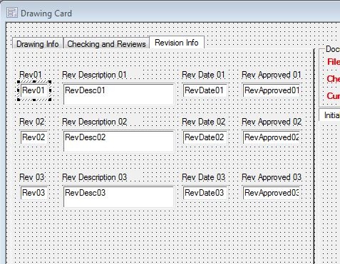

This is the card design....

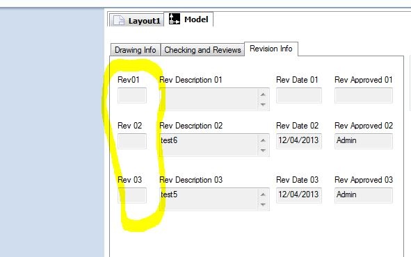

And here is the result after numerous trips through....
You'll notice the Rev fields are not getting populated.  Can anyone shed some light here?  I have tried setting the Rev01 to be %nextrevision% and just the plain revision value and I can't get this to record a value.  You'll see Rev02 and Rev03 don't get filled in, because they are old values of Rev01 as the revisions roll forward.
