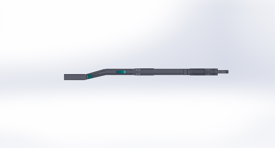

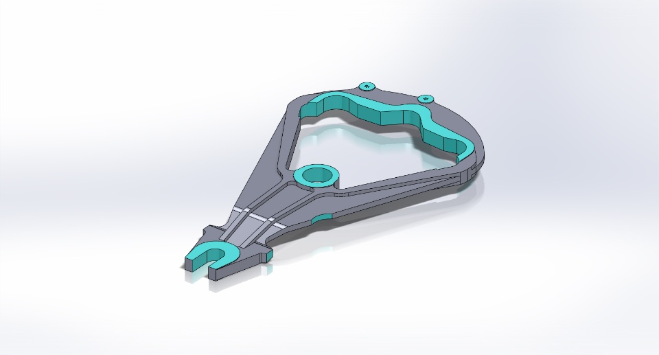

So I need to draft and the neutral plane has to be in the center throughout the geometry of the body. I have to split the body into half so that I cant give opposite drafts on each side which would like " < " or " > " throughout the geometry.
I'm unable to achieve this. Any Ideas ?

Create split line around the faces you want draft
Use draft feature and select parting line option and try.

Don't think i'm allowed to post the part. I could have used split line if not for the changing geometry by selecting the faces i want to split and a plane. As you can see in the front view, the geometry of the body changes and i'm unable to use the feature here.

M.V. You will have to use parting line draft as John has suggested. Planer/neutral plane draft only works with a single plane with no angles or offsets. You'll need at least one sketch following the center line of your part in the "front" view and do a split line/projection to the inside and outside surfaces. Then you can use parting line draft (2x). Then you'll have to draft each raised section on the top and bottom using parting line draft. Take a look in the user guide and or tutorials as you'll need to be familiar with this for sand castings, die castings and molding. Offset parting lines are quite common in these areas.  Regards - Donald

I just tried the split line projection with a sketch of the profile on the front plane and it worked.
