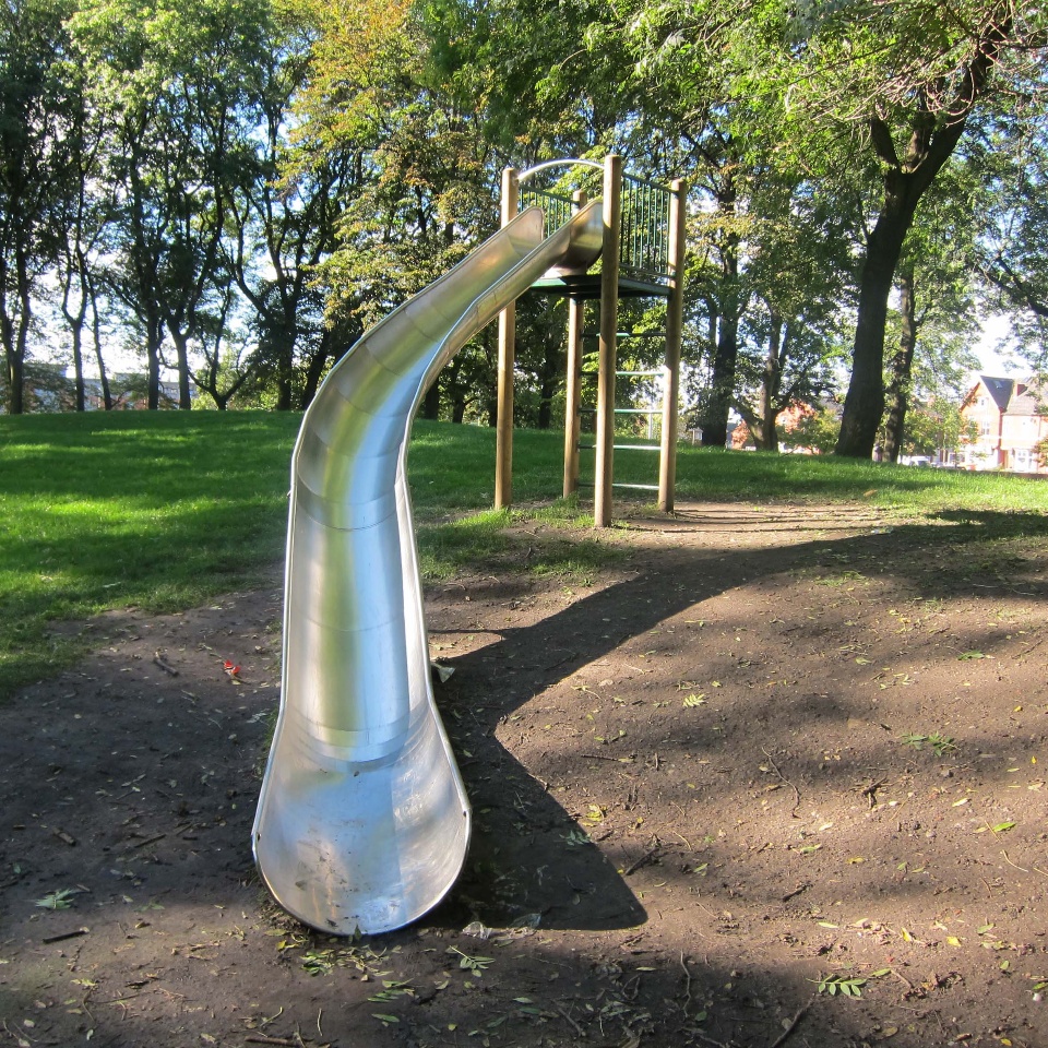

I work for a playground equipment manufacturer and I'm trying to design a slide in Solidworks which would be made from Stainless Steel.  I can design a slide which sweeps across 2 dimensions but cannot get the profile of the slide to sweep across 3 dimensions without twisting.
I am using a projected curve to initially get the path of the sweep.  I have tried to add guide curves to the sweep to restrict it and prevent this "twisting" but this wont work.  I have attached this file so you can take a look.
The slide obviously needs to be angular so that it can be cut into sections then flattened as sheetmetal to give the final cut profile.
I have used this method or similar to made the 2D slides before.  In this instance it has been used to made an air conditioning duct; http://www.youtube.com/watch?v=VU8EjtD6Tgk.
Below is an image of a similar slide we have made previously to show what we're after.  We didn't use SW to design this one.
I am also looking to design an 8m high spiral slide, but one thing at a time...

To not worry about twist, sweep a circle and then create a surface to cut away half the tube.

Here it is. Required alot of work. Had to create planes through the miter joints and did series of extrudes along a path upto the plane at miter. It does flatten and maintains the diameter. The one possible issue is that it appears to twist, but it really does not. To make the end of the slide so that it is parallel to the ground, it would require a spiral cut along the tube and that would not flatten out.

I don't mind you posting the parts in different formats at all, go for it.  Been looking at the file and video this morning and I'm really impressed.  Its just a shame the runout still isn't parallel to the ground.  Is there a way that each section could be rotated after each extrude to create a banking effect? This might then allow the runout to be parallel?

Also have just found some images slides which do this.  Note how in the bend it cambers up one side.
I also found this CAD image of spiral slide which offsets the centre line after each section.  I assume the same could be done with the half-round single bend?

Have taken a look this morning and I think theres been a missunderstanding with the word "twist".  You've actually twisted the steel section wheras I should've said the steel section is rotated around the centre point be a certain amount at each joint like in the CAD drawing of the spiral slide above.  If this could be done by using the move body feature or in the initial sketch it might work?  I'll have a play around with is today and see if I get any joy.
