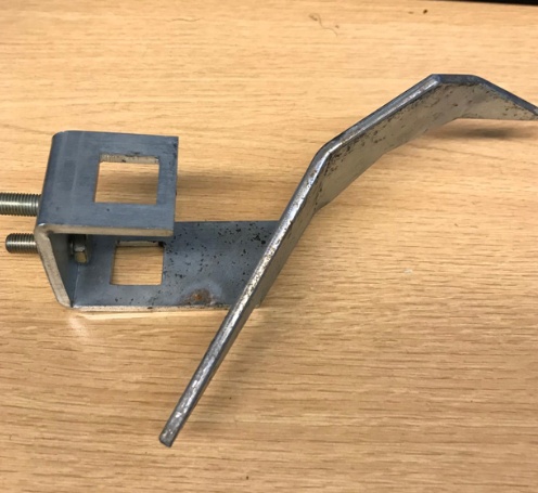

Need help creating this Pick
I was wondering if anyone can help me create this pick 3D in solidworks. I have a 2D drawing on file but this part seems a bit complicated to me...I've attached a dwg for this part. I need to make 2 versions of these. A left side and right. Is it possible if I just create the left side and use the move copy body feature to create a right side version.. Also to create this part, what is the best way to go about this. I never came across this type of part before so any help will be appreciated. I'm a newbie at SW but I'm learning!!!

Yes, it is, but the file that was sent to me didn't help much because the part had imported bodies which I couldn't see what was exactly done to create the part. I did feature recognition and still I wasn't able to see all the features in the part. I want to create this part with the right dimensions because the file that was sent to me was inaccurate and un acceptable, but without seeing what features were used to create this part, it's quite a challenge for me to create this. In addition, I need to create two versions of this part. A left side and right side. Is possible to create one side first and use move copy body feature to create the other and save as a new file name?

It was done by a user on this forum and what I don't understand is why did the person do multiple boss extrudes? Also, I'm fine with L shaped portion of the part. What is getting to me is trying to sketch the face of pick and I am not able to view the sketch nor features as that portion is a imported body..

That is a sheet metal part. Trying to create it using standard extrude and cut features is not the best approach. Go through the sheet metal tutorials if you are brand new to sheet metal modeling.
And if you need an opposite hand of that part, you want "Insert > Mirror Part...", which will create a derived part based on the original, where if the original changes, the mirrored part also changes. It will end up as two separate part files, rather than two configurations of the same file.

Hello,
I don't care for sketched bends, but here's some screen shots to get you going:
Sketch your flattened pick portion
Add a line in a sketch on the underside. Do a sketched bend
Create another line sketch on the pick back side and sketched bend (one sketch & bend for each pick bend)
Add two regular edge flanges
Not shown, but add a cut-extrude for the rectangular opening and use Hole Wizard for the holes (not cut-extrude).
I hope this helps.
