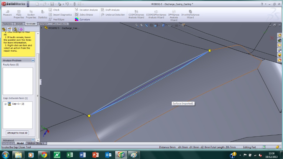

I was sent Five STP files and all but one were as parts. the other one came through as a surface import.
when i run import diagnostics it tells me i have one gap, heal gap does not work and if i try to close gap there is only one line.

Can you attach the part file?
Sometimes a .stp will come in with gaps but something like an igs or parasolid will come in solid.  Can you ask for another file type?

I'd like to see the whole part, but generally what's done in these cases is to trim away a portion of the surfaces around the gap (best to use a sketch with no sharp corners, IMO), and then repair the surface, usually by using the Fill tool (Insert..suface...fill).  If this is the only gap, it should be pretty easy.
