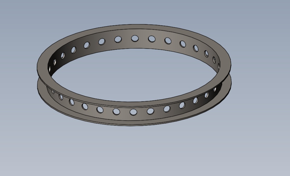

Name that part / Or what would be the standard name for this ring?
I am building a welding table that needs to rotate. i would like to use a latch pin to lock the table in position as part of the time it will be tilted at a 45° angle. I would like to source a stock part for the "lock ring" but nothing is turning up with my search terms. I am hoping that somewhere among the brain trust here someone knows the standard name for this part.
Thank you

Ring-Style Positioning Turntable
https://www.mcmaster.com/#rotary-tables/=17spkr6

You guys are on the right track. Unfortunately this table will be 16' square and will weigh in the neighborhood of 1500# with the assembly on it. The fun part is that the assembly will initially be placed on the table with the table flat and at waist level. The table will be lowered so the operator can install and weld components on top of 16" side walls. Then the table will be elevated and tilted to 45 degrees so the operator can weld everything together. It will need to be rotated so the operator can have access to all 4 sides. Nothing big.

Adjustable Locking Hub

indexing ring

Here is my concept. I am planning to replace the green bushing with a ring and a solenoid activated pin to latch it. i was going to use an electric gear motor to turn it but that was $1000+ and we typically don't spend that much on the whole jig.

I like this name too - it's more machinery name and  I can image without seeing the part

Without the electric gear motor, do you have cranes to lift the load around? As a weld jig, it can't keep its center of gravity throughout the whole process, and will have to be guided with applied force between locked positions. I like the solenoid idea which would replace the yellow lock bars in my image. Is your solenoid pin shaft slightly tapered for a self centering lock fit (with free space on other side to allow longer pin to clear)?
I cannot determine whether: a radial-action pin with an indexing ring, or a parallel-to-axis perpendicular action pin with flange base would be stronger or more robust. I'd primarily consider whether you are assembling store-bought (vendor) components or have full access to an in-house fabrication shop. Also, I can assume that this is a one-off or at most several-off jig design, not mass-produced, so a material-inefficient and bulky but easy to fabricate solution may be cheaper than an engineered just-strong-enough but more complicated to fabricate setup.

We are on the same page. It looks like this will be a one off jig with maybe 3 interchangeable heads that would each have the ring. That is why I was wanting to see if something off the shelf were available. The more I think about it I am leaning toward taking a trailer hub and spindle to mount it on for the rotation. I have looked at using an electric gear motor for turning the head. I would like to use a belt drive from the motor so it can slip if need be. I haven't done much with jigs before and this would be our first powered one so it will be a learning experience.
