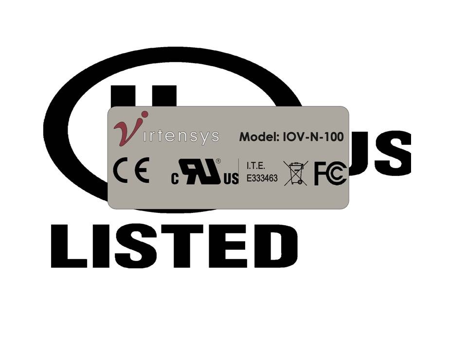

Mysterious workspace background picture appears in one part
One of the "decals" I applied to the part has mysteriously become the background view "scene".
How can I get rid of this?  Here's a view of my screen capture.  The HUGE UL logo is the background and the gray rectangular part is the 3D model.

I don't see the issue on my machine.  Maybe it's coming in from the Virtensys block that you are pulling in.  Try to roll back your feature manager to see when the issue disappears.  Also, I would recommend using decals instead of sketch pictures for this type of thing...unless you don't have access to PhotoWorks.

It didn't show up on my machine.
It may be a graphics issue with your particular machine.
Try a restarting SW or a reboot.

If the image is static in the background, it can be removed by View > Modify > Picture > Delete
It probably came into being by using the Insert > Picture function by mistake.

The background image stays there even when I roll back the features of the part to the beginning.
SF
SF 2010-10-07
That does it!   Thank you.
(VIEW/MODIFY/PICTURE/DELETE)
