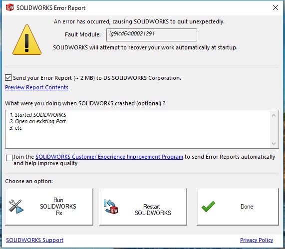

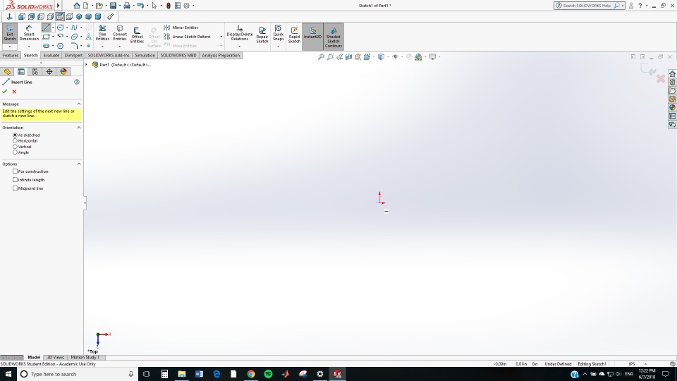

I open a new file and I want to start sketching but as soon as I hit the pen or circle or anything the program just crashes and do not give me any explanation.

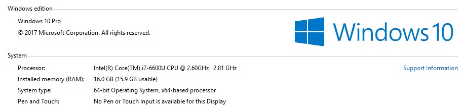

I attached 3 pictures. 1 is right when it crashes. 2 is the error page. 3 is my computer specs.

Can you run the computer properties and show the spec here

We had the same issue, same Fault Module. We updated from 2018 SP1 to SP3 and the problem appears to be resolved.
This is on a box using the Intel IGP. Windows 10 1709.
