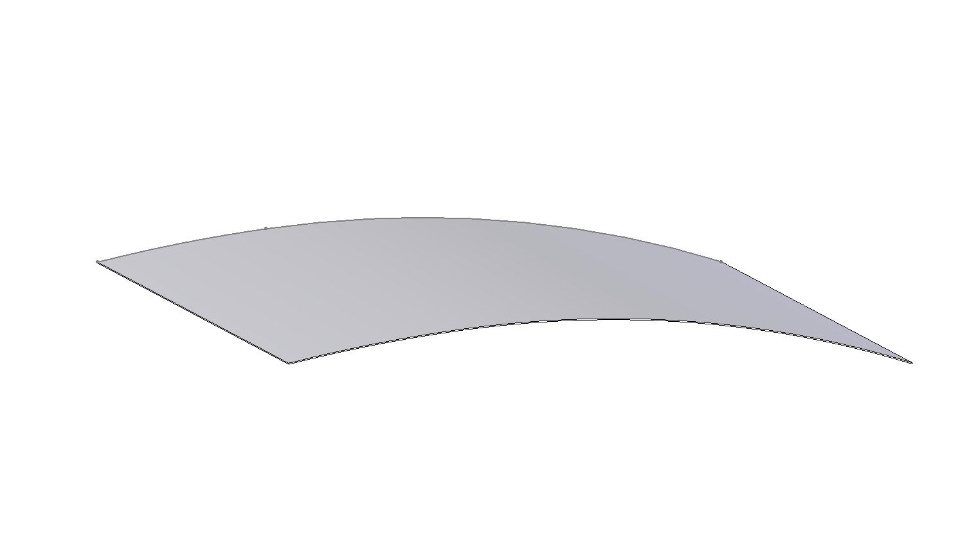

Although I've used SolidWorks for several years, I've neverhad to do sheetmetal parts beyond the occassional simpleL-brackets. I'm trying to make a curved skin that has two differentradii along the edge that are tangent. I've read the post 'CurvedMetal Sheet Part' posted by John Scott and was able to follow thatto get the part made. However, the example uses a single arc forthe base flange. When I try to flatten mine, SW gives me an errorsaying that the part contains features that cannot be unbent. CanSW2009 unbend multiple radii in this manner? And if so, what am Idoing wrong?SolidworksSheet Metal

Check out Sheet Metal Lofted Bends.....

Thanks for the replies. I'm not sure exactly what I did withthe SolidWorks sketch that was wrong (you would think its prettydifficult to mess up two arcs) but I imported the original AutoCadsketch as a dwg and it worked fine. Kind of weird, since overlayingthe two showed them to be identical.
I will definately check out the Sheet Metal Lofted Bends, since Ihave a lot of structure to build up next to that skin that followsthe same contours. Thanks again for the quick replies.

there could have been either a small overlap in the tworadii, or a small sketch segment that was causing the error.
and yea, the lofted bends is really nice.. I've just now startedplaying with sheet metal for a job we have, and a 15 min remotesession with my VAR probably saved me hours and hours of headaches.Especially with the eccentric cone I was trying to make..
