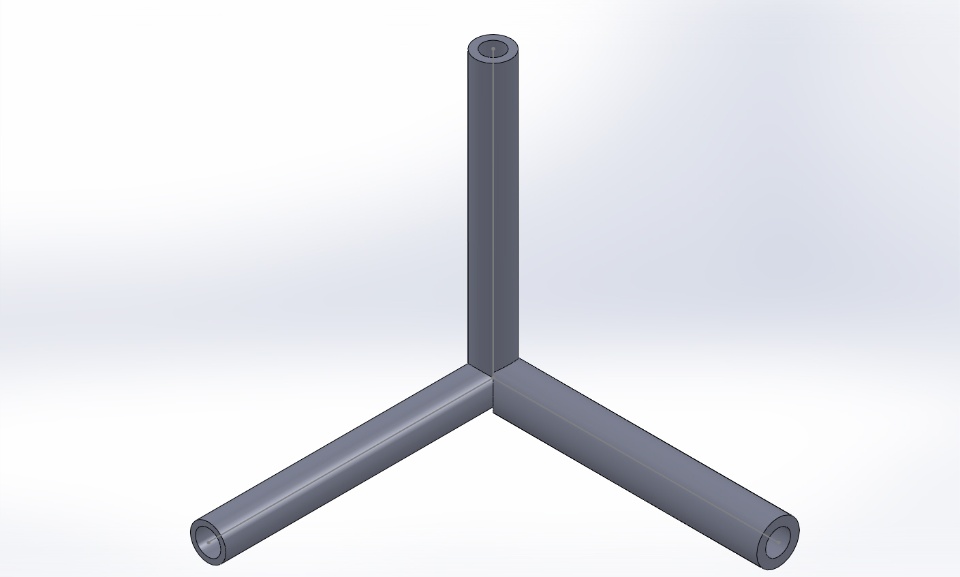

Attached is a view of the triad shape I was explaining.  I made the original sketch visible.
And essentially I have three different size pipes coming together as I explained in the original post.

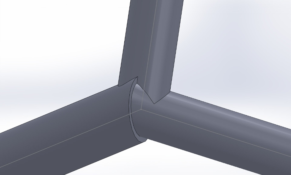

I also have a view of the back side of where the pipes all meet.  No it is not pretty, but that is what it would look like if you joined those three different sizes together, and obviously a weld would 'pretty' it up.
KB
KB 2012-06-13
not much you can do other than manually cut & extrude patches.
weld will help cover up but, it will only go so far.
the greater the variance in tube sizes the weaker the joint will become.

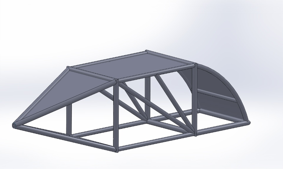

I made a test weldment piece with various angles and shapes and pipe sizes to the complicated level that the plane would be modeled in.  Two issues I ran into.  And the screenshot attached shows them obviously.  First is the corners on the main rectangle in the center has its corner sticking out, which is not correct at all.  Second is that the ' wrap ' laid on the plane of the sketch, not on the actual weldment feature.  Any way to fix these issues?  Thanks!
KB
KB 2012-06-15
for the corner it's a specific sequence of trimming.
you may have to do a manual cut.
you can create a plane on the tube surface and use that plane for the skin.

posted
KB
KB 2012-06-15
not 100% ideal but good enough to give you some ideas.
SF
SF 2012-06-18
Kenneth,
Can you actually explain what you changed from what I gave you, to what you posted here.  It looks much better, and something I can use to make this model much more realistic.
KB
KB 2012-06-18
don't be stingy with structural members.
don't try to put all the tubes in one structural member.
sometimes it takes multiple trims to get all the cuts needed on a tube end, even manual cuts.
it's all about sequence, groups, selection.
roll down the tree from top to bottom to watch the buildup.
you do not need the combine feature unless you want to do something like;
curved tube + straight tube + angled tube = one tube.
