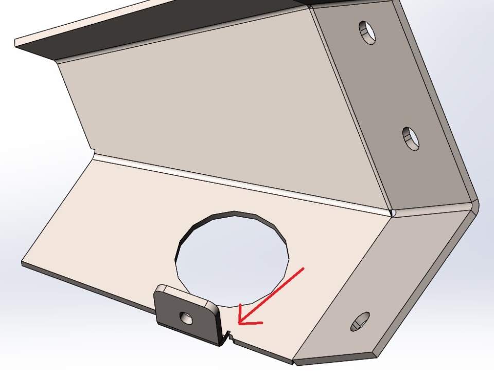

This first one is an isolated component within my multibody, and is a sheetmetal part that flattens:

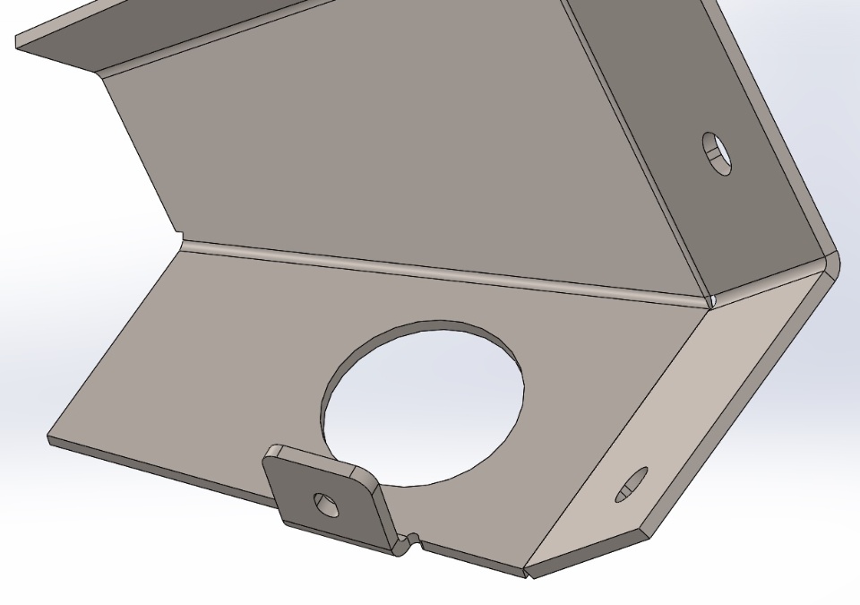

This second image is what it looks like after I've inserted it into an individual part file, and used the "Convert to Sheetmetal" feature:
Is there any better way to do this? I feel like I'm going around and around when trying to make individual sheetmetal parts when designing "top down"
