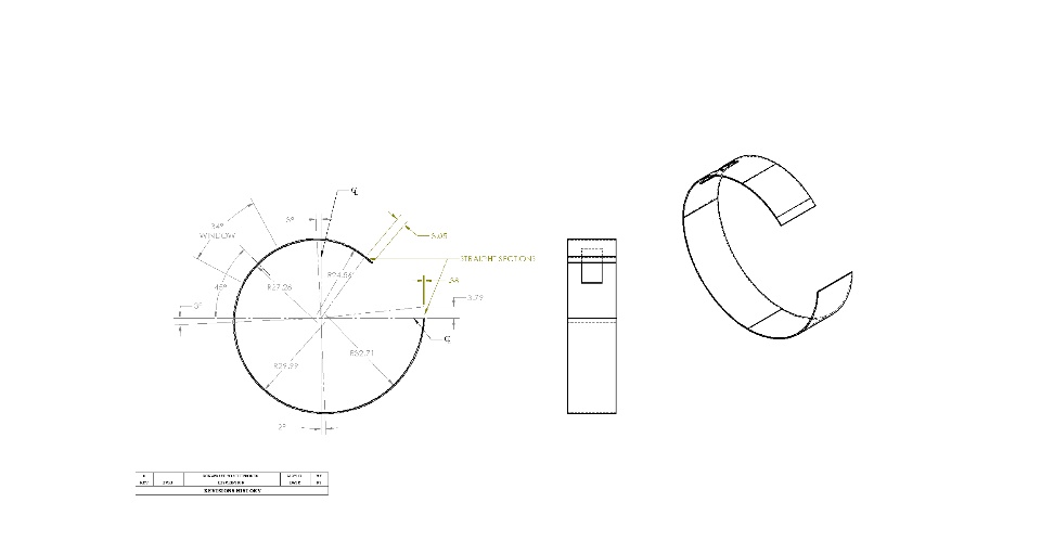

The part below has multiple radii and two flat lengths at each end.  I'm having trouble getting the flat pattern.  It always has at least one item that can not be unbent. I originally made a sketch of the complete profile and then used 'base flange' and selected the sketch to create the sheet metal.  Then I did a profile of just the radius sections and added the straights as edge flanges.  Same results.  Any ideas?  I've attached the model Thanks!

The radii need to be tangent.  I added the tangent relations and made the 34.427, 31.747 and 29.033 dimensions DRIVEN.

That was it.  Though, I would rather control the radii but I can live with it.  Thanks!
