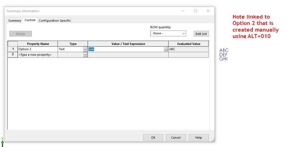

Is it Possible to define a multi-line value (value with line break) in custom property tab builder?
For example,
When the user choose Option 2, I want to create a custom property with value
ABC
DEF
GHI
I understand that i can create the line break manually using ALT+010 when i defining the value manually in custom property, but this does not seem to work in custom property tab builder....

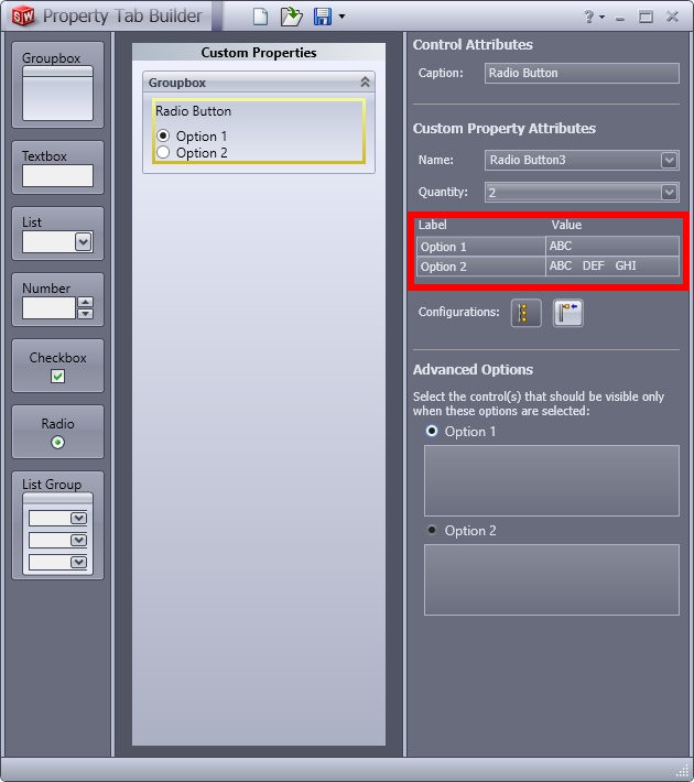

Is there any way to create multi-line value when using custom property tab builder?
The only workaround that i can think of now is to create a "Dummy" property manually (with line break) in the part template and have the value of Option 2 linked to the "Dummy" property when selected...
This will get messy if the user did not start the part with the part template but decide to use the custom property tab created...

ZT 2023-05-11 Best Answer
Revisiting again
A more elegant solution is too update the .XXXPRP file using notepad and include the linebreak directly in the xml code using   ​​​​​​​

The linefeed trick works. With a major issue. Linked drawing notes won't update if you change the property value in the property tab builder. Well they do if you double click them. However if you change the property in the standard input window then the notes and properties will change as intended.
To summarize. I found the property tab functions not reliable in 2016. Use with caution.
comment imagecomment image
