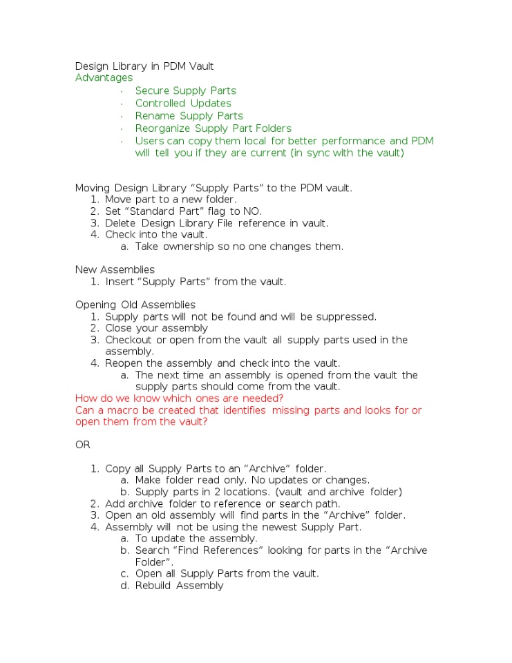

Moving the Toolbox is easy and I think it would be in your best interest to move it to a network drive.  Just move the Solidworks Data Browser and the CopiedParts folders.  Then change the location in Tools Options Hole Wizard/Toolbox.
The design library is near impossible to move depending on what's in it.  For annotations, features and things that get copied into you part or drawing it's no big deal.  Just move the folders and files.
But for parts and assemblies it is difficult to move or rename any of the files.  The best idea I have come up with is to put the design library parts in PDM Workgroup.  Here you can move files around in folders or rename files and references in files are updated.
I have experimented with the attached procedure but need to do some more testing.  The procedure refers to the parts in our design library as "Supply Parts".
We have 1,200 files in our design library.  It's shared among 20 engineers at two locations.  We have thousands or assemblies pointing to poorly constructed Design Library folders.  I have to make sure I test and test again to make a seamless transition.
If we knew we could never move or rename the folders we would have never created them.  Design Library is a poor idea for long term records.
We under estimated the value of design library "Supply Parts".  The parts are simple and don't take much to create.  Some people say don't put them in your vault because you don't want to revision manage them.  But think about this.  If you have a machined part or weldment you loose it only affects one or vary few assemblies.  You can most likley recreate it and repair the mates in your assembly in a couple of days.  If you loose a simple bushing that was used in hundreads of assemblies you now have a much large job.  It will take a long time to fix everywhere you used the part.  For this reason I think simple supply parts are more important from a time standpoint then the complex part.
