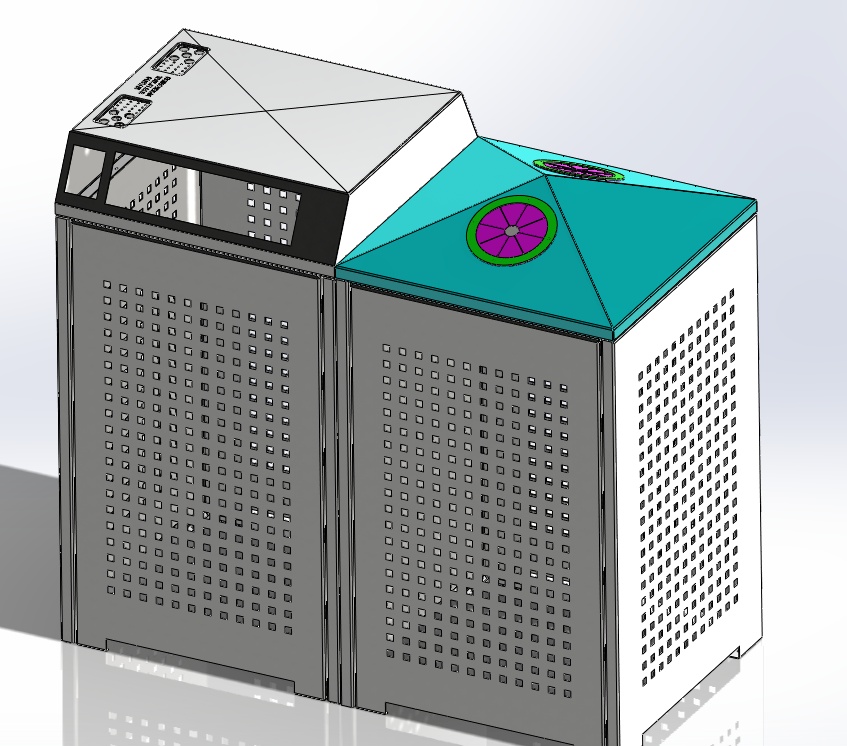

Hi all,
I am self taught at SW.
I was wondering how can you move parts from an assembly file into a sub-assembly file and maintain all of their relationships?
If you look at the screen shot you will see I have made a bin with a lid, entry ring and rubber flap.
I would like these to form a new assembly within my current top level assembly and maintain their relations to the other parts in the file.
If some one could please list a step by step method they use that would be great!

Brent,
I'm just leaving work, but briefly, select (in the feature tree) all the components you want to make into the new sub-assembly and select "form new sub-assembly here" from the RMB menu.
Now home. Editing to add pics.  Simple assembly, 2 screws & 2 washers, all one assembly.
To make a sub-assembly of 1 of the screws and it's washer, select the screw and washer and RMB.
Click on "Form New Subassembly Here" in the menu that appears (click on the double arrow at the bottom of the menu if you don't see it).  You now have a new virtual assembly.
Right click it and select "Open Assembly". Then "Save As" to make it a separate external assembly.
I saved this one as "new assembly".
Depending on how you mated the parts and what in context relations you have, the ones that can move to the new assembly will and you should get a warning that the ones that can't will be deleted.
You can also RMB on just one part and "Form New Subassembly Here", then drag and drop the other parts you want from the top level into the new subassembly.
I think that should get you started.
