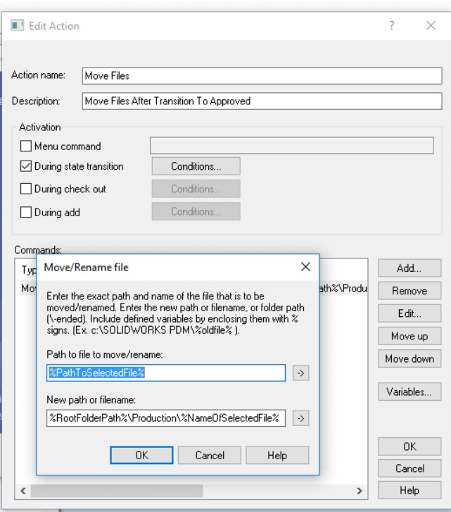

I am trying to move a pdf file to another folder.  Everything I try does not work.  Has anyone successfully moved a file to another folder in PDM using Dispatch?  I am on SW2017 SP5.    Below is an example:

I do not the move the PDF but I copy it to another location.  I believe the top box should be set to %NameofSelectedFile%.

Thank you for all the suggestions.  I did get to the bottom of this and found out that my Dispatch was not updated from 2016 to 2017 (which introduces the move function).  Hopefully, this will help if anyone else forgets to update the dispatch in admin tool.

Hi,
I apologize for the long answer (I was absent).
I have looked at script. He differs from script on picture - an ending - ".pdf"
Here it shouldn't be.
PDF - has to be specified in the conditions of Activation of script.
What line in "During state transition"?
There has to be: %\%.pdf
If there is no it, there is other decision.

If you get any error while running dispatch,then attach error image
SF
SF 2021-04-09
Please find attach script.Check whether Production folder exit or not.Also,check the location of Production folder as mentioned in dispatch script.Check the attach screenshot for reference

Hi,
If folder "Production" not exist Dispatch script do not work.
If folder exist - check user/group settings (permisions to move file).
If to add menu command and it will work - the problem in Workflow means.
I tried through menu command - there are no problems.
Can the file type is incorrectly specified or it is corrupt of other application?
Still, check/add extension of "PDF" in settings of adding of files is perhaps necessary and to set them "automatically".
If there are no listed problems, then to try instead of move - copy (as advises Steven), and then if it is necessary - to add to a script "to delete the file".
It precisely shall work.
Also, perhaps instead of %RootFolderPath% there shall be %NameOfCurrentVault% or something else, where there is a "Production" folder?
