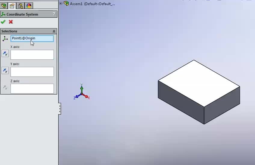

John, this is to create OR move the existing coordinate system which has been created via Insert > Reference Geometry > Coordinate System
Like in the attached video, I've moved the CS1 to a new location.

Is there anyway to move the coordinate system to the center of a circle?
I have done it creating previously a point at the center of the circle, but I don't know if there is a more " cleaver" way to do it.
DG
DG 2015-03-12
You could set the circle sketch to show and then use the center point to define the origin for the coordinate system.

Hello Deepak,
Good suggestion when you have the sketch in that face.
The problem in my case is I have extruded the circle and I need to put the origin in the extruded face.
Better an image. I need to put the origin at the selected ( orange) face.
comment imagecomment image
DG
DG 2015-03-12
Sorry no direct way. You need to place a sketch/reference point on that face.
