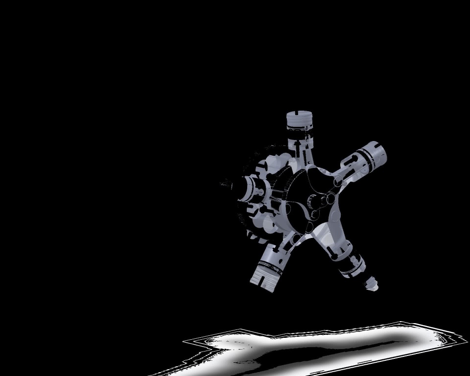

Is there someone in this SW community that is knowledgeable about motor driven animation (or animation in general) that would be willing to look at my radial engine to see if they can figure out why only some of the objects in this assembly move for the animation but work fine when moved manually?
I could zip and 'YouSentIt' to a volunteer.

Edit: Reuploaded as figured out the timing better.

I would be interested to look over it. BTW what is the RPM and FPS you've set.

Thanks Deepak. I sent a link to download in a private message.
RPM is 200
FPS was the default 7.
I hope that you will be able to find out what is wrong, as I am at a complete loss.

I just wanted to say thanks to Deepak for having a look at my radial engine. Deepak could find nothing wrong with the modeling but did find that a full animation could be achieved only by saving to a series of stills as opposed to the AVI format. I tried that and found that this was the case. I didn't know how to loop a youtube video. Here is a short clip.

Nice motion. Use PhotoView 360 as Renderer to get more realistic rendering.
