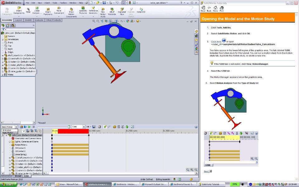

I am new to solidworks and have been going through the tutorials.  I am trying to do the motion study tutorial but I am having trouble.  I don't have Motion Analysis listed in the type of study dropdown.  I have solidworks premium and the solidworks motion add-in is installed.  Any idea why I don't have Motion Analysis.
I attached a picture of my screen shot.
Thank You

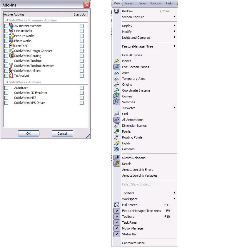

I have solidworks premium but I don't have as many add-ins (see picture).  Under view it shows that motionmanager is on, but I don't have the motion analysis choice.  This is my work computer so maybe they didn't install it.  I assume it should install with solidworks unless it allows you to choose what add-ins to install alongside solidworks.  Could it be that I don't have the latest SP?
SF
SF 2010-07-15
In the installation process you can choose if you want to install simulation product or not. It looks like they did not install it. If they did you would have Simulation and Motion in your list of add-ins. It is not a SP issue.
KP
KP 2010-07-15
Just to back up and agree with what Wayne wrote - it's an installation thing.  I remember now that I did this once a couple of years ago by being a bit non-thorough in the installation process.  Just need to repair the installation and be sure to click on all the Add-In options.  To repeat - it's not a SP issue.  Motion is standard in SW Premium.

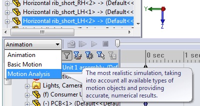

Hope my comment helps to the people who came with this same problem.
First make sure your subscription have solidworks motion.
Then turn on solidworks motion by tools > addins > solidworks motion.
Here comes the important point, Make sure that you select the solidworks motion icon avaliable at solidworks addins tab.
