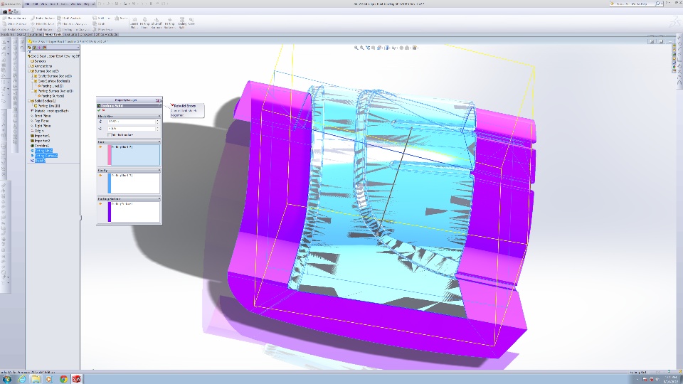

I'm trying to figure out why I keep getting the rebuild error "Cannot knit sheets together." while trying to make a tooling split of my cowling section.
I've tried it using the part as either a STEP or Parasolid....
Here's a screen shot.
All help will be appreciated.
Thanks....

If you do a geometry analysis, it shows 8 short edges and that may be causing a minor gap between core/cavity and parting surface
Try "delete face" with delete and patch option
Then update the parting line and parting surface
JG
JG 2015-08-11
I have gone bit more into the split and noticed that the automatic parting surface is little tricky and did complete manual surface using surface tools.

That looks great...so, did you make the fixes with the delete face and patch option? Or was it something else? And yes, the automatic parting surface didn't work for me either...I had to do it manually. If you still have the corrected file, I'd like to see it.
