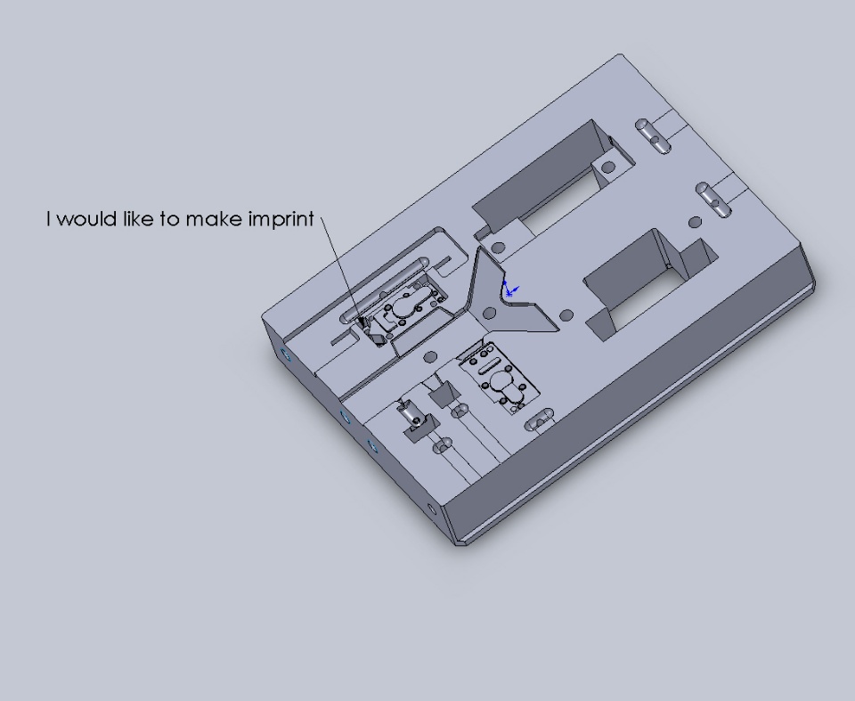

I have pressform for mold design of aluminium details. I would like to make an imprint in order to make elektrode.
Can anybody help me?

DG 2010-08-05 Best Answer
Use offset surface with 0 value and get the internal surface. Knit them to make solid and finally model your electrode
OR
Extrude a block (don't merge and create a separate body) and use subtract option in the combine feature (Insert > Combine). Subtract the press form from the extruded block.

You looking for making a electrode and not mold, so you can use either of the methods I have suggested and not the mold tools.

Mold tools are easy to use but yes sometimes you might need to take addtional helps of other tools like solids/ surfaces, etc. You can also use the methods I have suggested for making molds.

you can also use the cavity tool in assemblies...works great. was the only way to do it before the combine tool. insert new part, extrude block and then use the cavity feature, then do any mods that are need to refine the trode.
