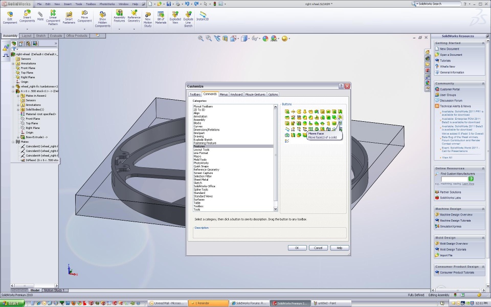

Shooting from the hip, without looking at the file.
Have you looked at the move face command?  In order to move a face across several holes, you might have to delete and patch those holes, but this will allow the rails to be shortened without a cut.
Is this really a better method? No, not really!! I would say the cut is likely a better method because it allows you to control the overall length vs. telling the software to shorten the rail by x amount.
How do you then move the caps in place? Move / Copy body using the mating style method.  Insert -> Feature -> Move / Copy Body.
Regards,
JPD

i would use the cut feature.
then use the move/copy body feature (mates) to re-align the end cap.
piece of cake
feature works is a waste of time.

The easiest place to find the move face command is to right-click on the face, press the Down arrow at the bottom to expand the menu, and one of the options in the Face section should be "Move".
But I might still use the cut because, like I said, it gives more flexibility to incorperate design intent vs. the move face.

Thanks for your help guys.  This excercise taught me 2 new commands.
I ended up like you suggested Ken keeping the cut and Moved\Copy the remaining solidbodies
and mating them to the new face.

The move/copy face command worked perfectly for what I needed it for.
