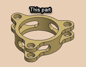

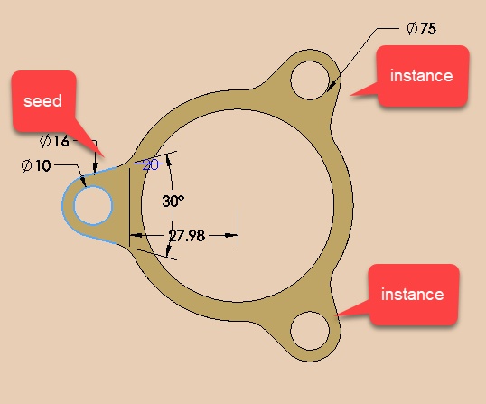

I want to modify this part to change the structure shown in the screen shot. If modifying portion is on the X axis it is easy to modify. But seed is coming on X axis instances are not. Is it possible to bring one of the instances on the X axis? I tried with move/copy command and change orientation command but it didn’t work.

..just cut one off 1 of 3 and add/replace with the vertical couplers?

This was where I got this drawing but I don't like this method. I am looking for easiest way to do modification.

I don't know what the original intent of the change was, but my assumption was the seed was the geometry that needed to be "rotated 90 degrees to vertical" and it needed to stay in the same relative location so proposed the approach I showed. Another approach to accomplish that exact thing would be to edit the pattern to change the number of instances to 2 instead of 3. Then use Move/Copy to rotate the solid 120 degrees so the empty space of the pattern is where the seed used to be. Then you can add the plane and 3 new features.
But, since this is an example model for model mania, my other assumption was to do it in the absolute quickest method possible (since that is the goal in model mania). Plus, on a model like this, the geometry regeneration is so quick, using delete and patch to accomplish it likely has the same or faster regeneration and keeps the same exact, clean geometry so is a perfectly valid modeling approach.
In reality, I just looked back at the part that Maha attached and the tab that need to be rotated 90 degrees IS NOT the seed as was labeled in the original post (I never even checked the features to see). So, the two patterns could be edited to have only 2 instances (and flip the direction on each) but then to have a clean model, fillets also need to be edited to take out the removed fillet references from the 3rd instance that is now gone. Then finally, the plane and 3 new features can be created. This would take MUCH longer in a model mania situation to get the resulting geometry, so I would STILL go with the delete and patch approach.

GH
GH 2021-04-09
Interesting that there is so many varying answers.
My approach, (given that I only looked at the picture & drawing & not the model), would be to eliminate the circular pattern, do a mirror of the 120 degree slot & horizontal tabs, then create the vertical tabs.
I feel like creating a feature, then deleting parts of it is messy. But I'm open to hearing why it's better.
