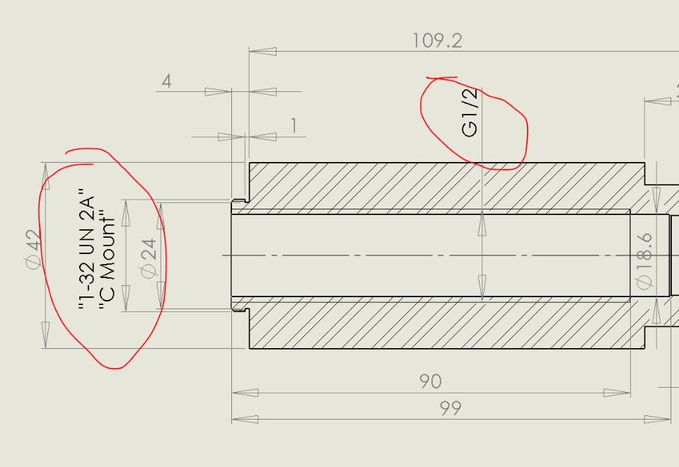

Is there anyway to make the thread callout come out looking like a dimention instead of a note? See picture
I currently do a workaround of placing a dimention, deleting it's text, placing a thread callout, deleting it's leader, and then placing it where the dimention text used to be.

You can always select the diameter and then over-write the dimension text (SW will ask if you want to as it will no longer be driven by the model) but I would ask why you would want to since it is a non-standard dimensioning scheme. Are these prints for a machine shop that is in-house and what is the volume (one of a kind or a million)? If you are sending prints someplace other than to a machinst that you can talk to frequently then the prints should be to a standard otherwise they are just confusing. Not to be preachy, just sharing. One other small thing: 1-32UN 2A should be a 1-32UNS-2A as it's not a standard thread and C-Mount is a designation for the location of the image plane / detector, not the thread type. the machinist won't have a standard for a C-Mount. Typically I'll generate the thread data for the machist and place that on the print for non-standard threads.
