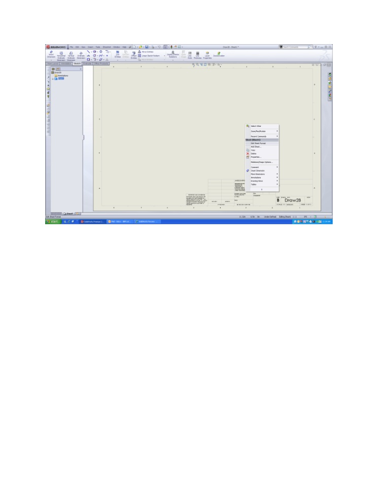

Thms, It took me some time to figure out how it was done and I don't think someone will be able to explain it in good detail to you on the forum. Does your Var offer any training? If so contact them. Also look at attachment. When you call up your drawing template, you need to RM and click edit sheet. This will allow you to edit the fields you want to populate.
