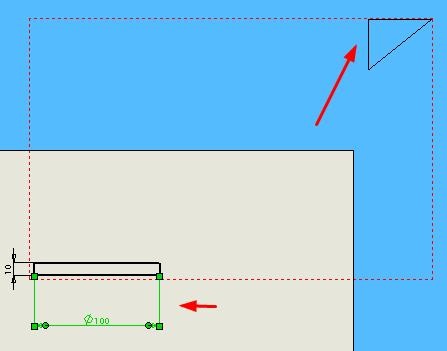

ModelToViewTransform+MultiplyTransform
MultiplyTransform + ModelToViewTransform,
result is error .

SolidworksApi macros
Answers 2
JA
JA 2017-01-04 Best Answer
I think the problem is that CreateLine2 is using the drawing coordinates and you are giving it the view coordinates (or vice versa).
When I attempted this a while back, I ended up just building a transform from view sketch to drawing sketch coordinates because I couldn't figure out which API-provided transforms to use.
YN
YN 2017-01-04
Thanks your tips.
Question is using the drawing coordinates and you are giving it the view coordinates?
<p style="font-family: Verdana, 'Verdana Ref', Geneva, Tahoma, sans-serif; color: #333333;">Just follow these steps and you shall get the correct results: -</p><ol style="font-family: Verdana, 'Verdana Ref', Geneva, Tahoma, sans-serif; color: #333333;"><li>Get Point from vertex (as you are currently doing).</li><li>Use ModelToViewTransform to transform this point to the view space. (Multiple vertex point with ModelToViewTransform)</li><li>Get the Sketch of the view (using view::GetSketch()).</li><li>Get ModelToSketchTransform for this Sketch.</li><li>Use ModelToSketchTransform to transform point (generated in step 2) to the sketch space. (Multiply point generated in step 2 with ModelToSketchTransform).</li><li>Activate the sheet.</li><li>Activate the view.</li><li>create your spline.</li></ol>
